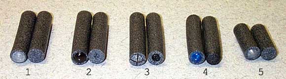

Since my guns are all modified to use micro stefans, that's what I made. I made 4 types of 2.5" dart and one 1.5" to throw in a quick length comparison. The four varieties (in order) are: nothing done to the back of the dart; 13/64" hole drilled halfway down the length of the dart (taken from Stefan's original); a 3/4" long hole melted in the back of the dart with a soldering iron; a slightly "tapered" dart with the back end melted and rounded off somewhat - an attempt to make it more aerodynamic. The short darts have nothing done to the back. I made two of each so that inconsistencies in manufacturing wouldn't throw off the numbers too much. The tips are color coded to help me easily distinguish them during field testing.

Dart Type Avg Distance (feet, inches) Variance (Max - Min) 1 88', 10" 215" 2 84', 10" 461" 3 88', 7" 125" 4 81', 8" 293" 5 86', 11" 213"
All of the darts had similar flight characteristics and were equally accurate except for type 5. The smaller dart took longer to achieve a straight flight path and was somewhat less accurate. While body type 3 demonstrated greater distance consistency than the other darts, I'm not entirely sure the difference is statistically significant given my small sample size and great variance among the types. What is clear is that there is no distance gain as a result of modifying the back of the darts.
